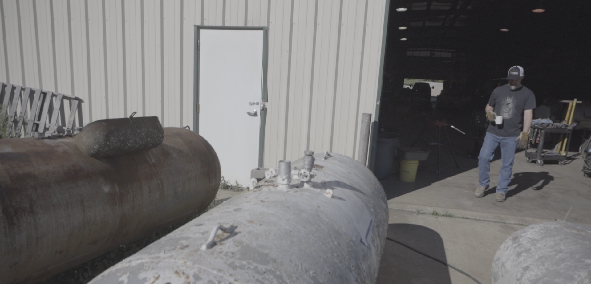

Used propane tanks lined up outside a shop
The tank shows up already purged with the valves taken out. That's the whole reason to go that route. The dangerous part is already done for you.

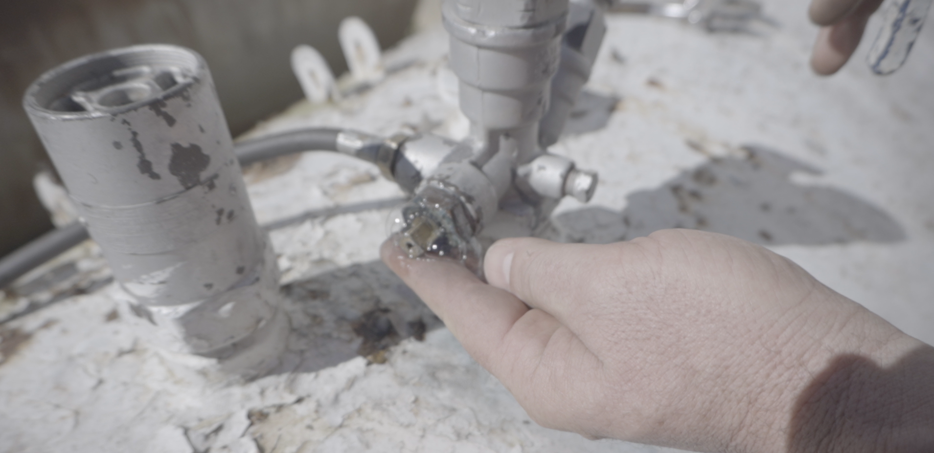

Close-up of the valves still installed on top of a used propane tank
The tank in that picture still has its valves in. That's not ready to buy for a smoker.
Look where the valve was. It should be an open hole. If the seller can't tell you it's been purged and the valves are out, walk away.
A couple of things to know about why:
  • The gauge doesn't tell you what you think. The gauge on a propane tank shows how full it is of liquid. It doesn't show pressure. A reading near zero does not mean the tank has no pressure in it.
  • It's not just the propane. Even with no pressure left, there can be mercaptan sitting in the bottom of the tank as a liquid, with propane vapor still mixed into it. The heat from cutting makes that mercaptan and propane vaporize fast, and it flashes off. If the tank doesn't have a big enough opening in it, it could rupture, depending on how much is sitting in there.
