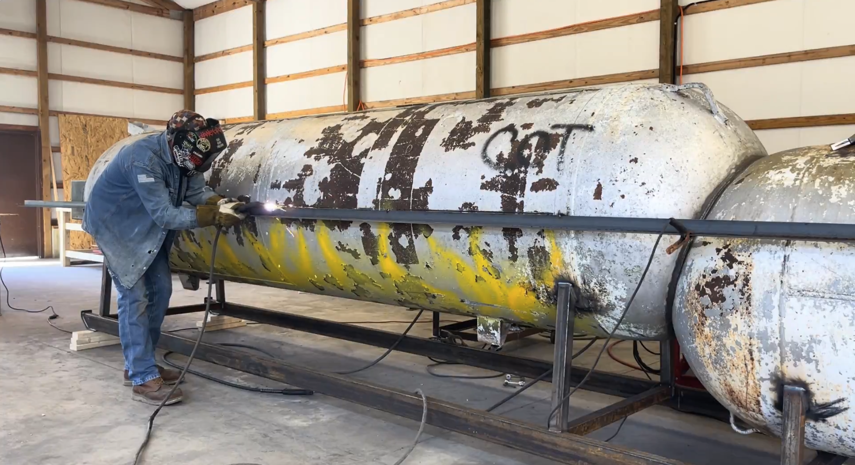

Propane tank sitting on leveled stands in the shop before layout
Every line you lay out on that tank comes off it. Top dead center, the 3:00 line, the doors, the collector box, the firebox opening. If you've got a quarter inch of fall across your stands, all of that is a quarter inch out.
Here's how I set it up:
  • Stands with a V or a swoop on top. That keeps a round tank from rolling. I put a T foot on the bottom, usually about 10".
  • Level them with a laser. Bump a tape off the top of each stand and read the laser on it. Shim the low side up. You can't make a stand shorter without cutting it, so you always shim the low side.
  • Keep the stands in out of the way. The tank is going to sit there a long time. Set the stands in far enough that they're not under where you'll cut the end or put your drain, so you don't have to move anything later.
  • Tack each stand to the tank. Put the tack somewhere you can cut it easily later. You're just keeping it from rick-racking and rolling around.
Check: after you shim, the laser should read the same on your tape at both stands.

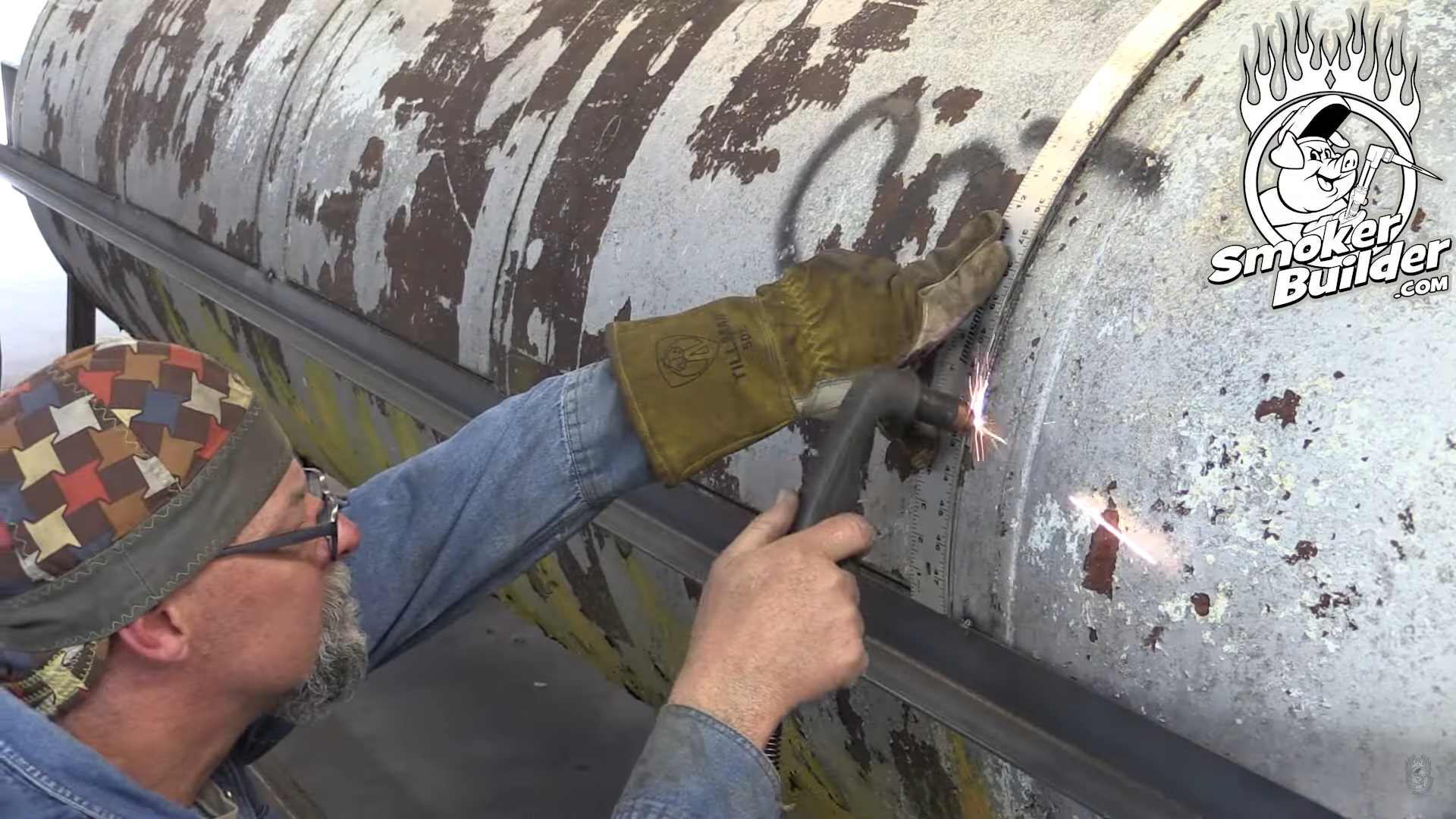

Plasma cutting along a straightedge on a propane tank sitting on leveled stands in the shop
Square off the factory head weld seam. It's a machine seam, not a human weld, so it's reliably square. Use a center head square to find top dead center, and a chalk line to carry lines around the tank.
Lay out everything you'll need… top dead center, the 3:00 line, the collector box, the firebox opening and the drain.
That 3:00 line is where I like my cooking grate. It's also where the bottom of the doors gets cut later. On an offset, the top of the firebox lands at or above that grate line.
Check: check your lines with a 3-4-5 triangle before you cut anything. 3 feet one way, 4 feet the other, and the diagonal should read 5.

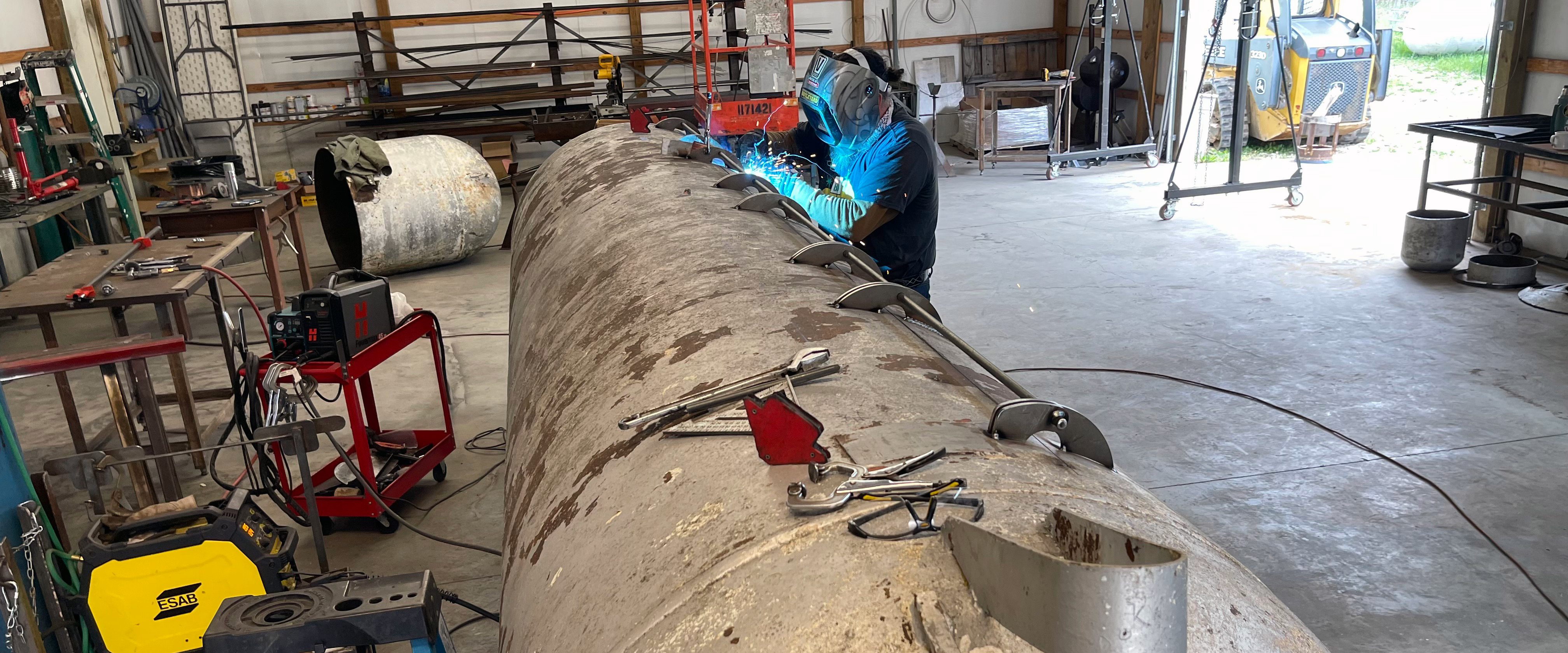

Frank Cox cutting the cook chamber doors on a propane tank
Lay the doors out and cut them. A couple of things I do here:
  • Bring the top cut down around the front. On a 250 I'll come down about 4". On a 1,000 gallon it's closer to 8". That takes weight out of the door and can help you skip a counterweight.
  • Hinges go on after the door is cut out. Not before. Otherwise you end up cutting hinges back off.
When a door won't line up. About 70% of the time it's the tank, not the doors.
A little spring is normal. Up to about 3/16" is a judgment call and I leave it. More than that, pull the tank back true. A Porta Power or a lever chain hoist does it, or round bar tacked corner to corner across the door. If you follow the order above, you probably won't need gussets of any kind.
Welding hinges onto the cook chamber doors of a tank smoker
More on that: Fixing a Warped Smoker Door? Watch This Before You Touch It
Check: put a straightedge across the door cut. Spring of 3/16" or less, leave it. More than that, pull the tank true before you weld anything.

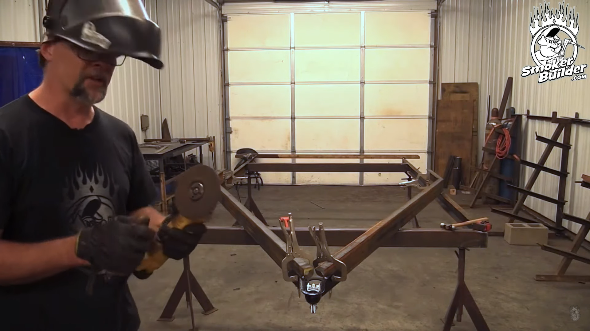

7. Build the trailer
Finish the cooker body, the cook chamber and the baffle before you start the trailer.
Smoker trailer frame being tacked together in the shop
You need the finished smoker to know what it weighs, where it balances and where it mounts. That's what lays out the trailer.
I build the trailer upside down, weld out the bottom, then flip it. Axles get hung, the tongue and crossmembers get welded out.
Leave the fenders and light boxes tacked until the smoker's on. A fender may need to slide over to clear the firebox. Keep the firebox about 3 to 4 inches off the axle too… that's heat you don't want on it.
Axle size goes back to how big the pit is. There's an axle table in the first build article.
The rest of the trailer: How To Mount The Tongue And Coupler and Installing Tandem Axles
Check: the trailer is a finished rolling chassis before the smoker comes near it. Fenders and light boxes can still be tacked.

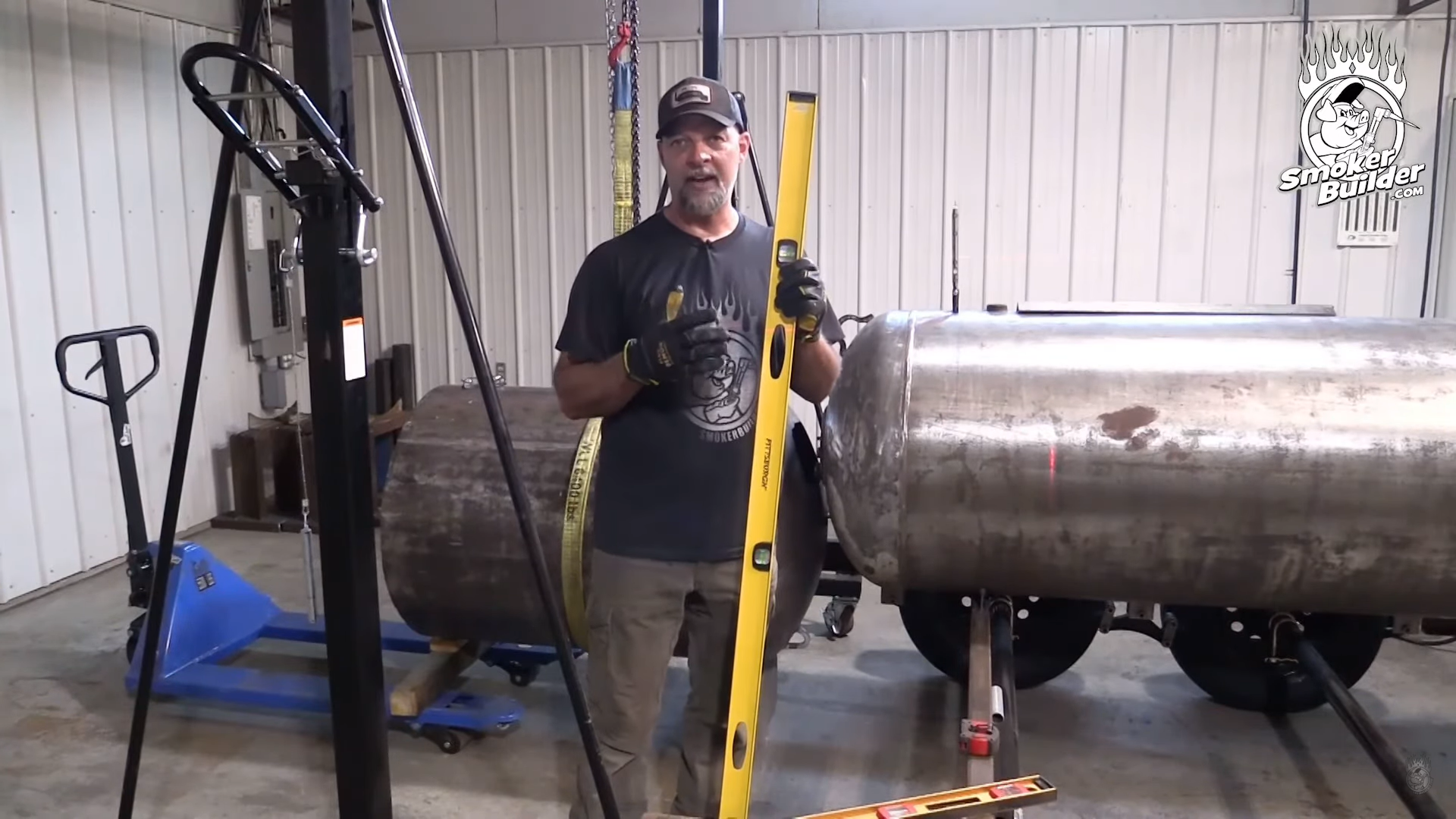

8. Mount the smoker on the trailer
By now where the smoker sits front to back is already decided. You set that when you placed the axles and crossmembers. So mounting is lift it, match it, bolt it.
  • Powerwash it inside and out first. You'll be welding inside the cook chamber later and you don't want to be laying in loose scale.
  • Pick it at the center of gravity, not the middle of the chamber. The firebox end is heavier. Rig to the lift rings but pick toward the firebox, and keep tension on the lifting device.
  • Back the trailer under the smoker. Move the trailer, not the smoker.
  • Match the smoker's pitch to the trailer. Not to true level.
  • Dry set it. About 1/2" between the firebox and the rear crossmember. Chamber bottom resting on the front crossmember. Parallel to the frame rails.
  • Bolt it, don't weld it. Shop-made brackets, 1/2" bolts, washers and nylocks, with a 1/2" washer spacer between the brackets so the smoker lifts back off.
  • Pull it into final position with a ratcheting chain hoist. Take the rigging off only after it's bolted down.
Check: about 1/2" of clearance at the firebox, the washer gap is visible, and it's bolted before the rigging comes off.

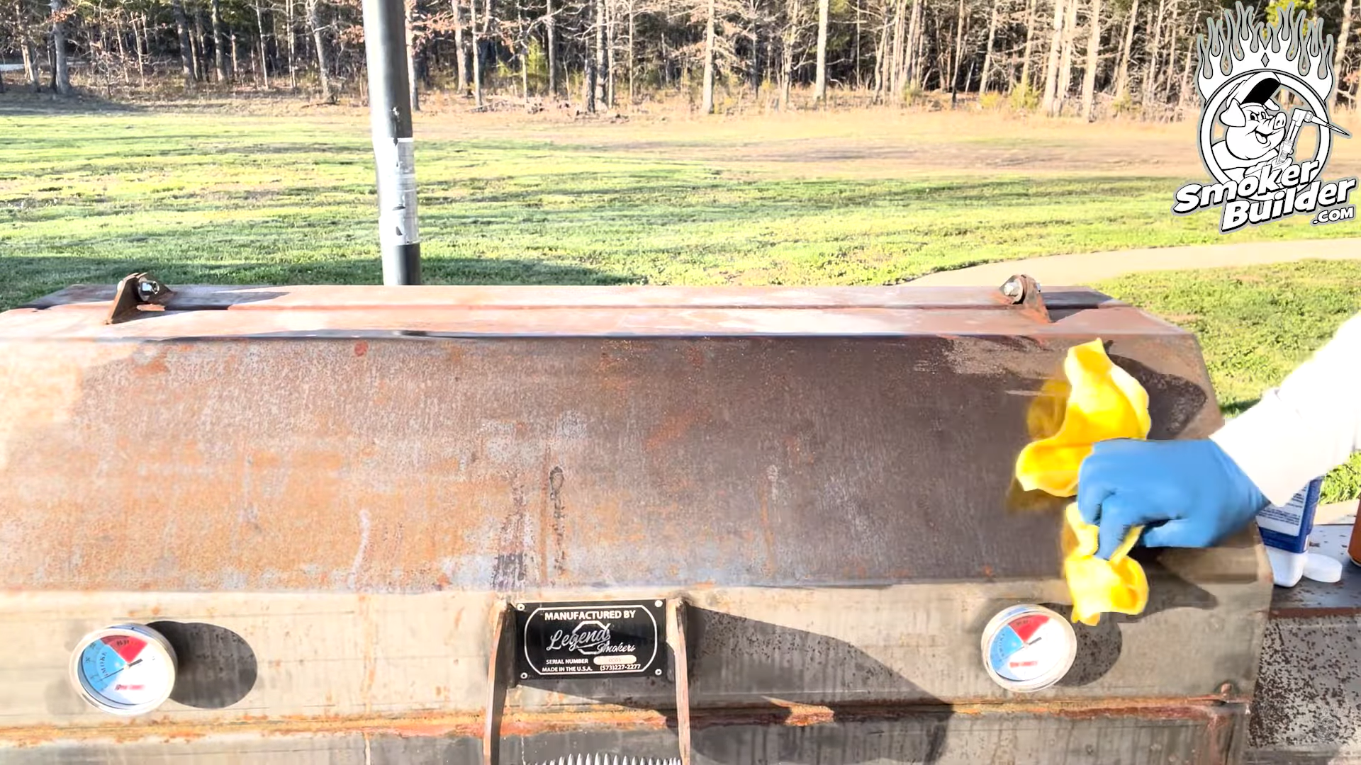

9. Finish it
On this build, the trailer got painted and the smoker stayed bare steel and got oiled. Painting the outside of the smoker with a 1,200°F high-heat paint works too. It comes down to the look you want.
Wiping oil onto the bare steel of a finished smoker
That's why it's bolted on with the washer spacer. Lift the smoker off, paint the trailer, drop the smoker back on.
Linseed oil goes on cold steel. Inside the cook chamber use a food-safe oil, and let it cure before you cook on it. The whole finish, step by step, is here: How to Season, Burn In, Paint and Rust-Proof a Smoker.
How I oil a smoker: How to Protect Your Smoker with an Oil Coating
Check: trailer painted and cured, smoker oiled, and the inside cured before the first cook.
