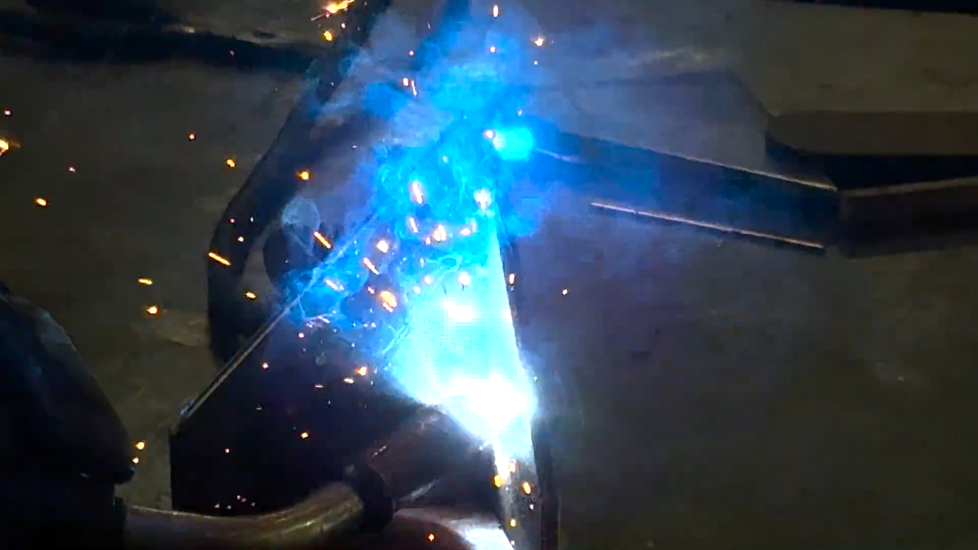

Buy a MIG welder. Gas-shielded, 200 amps or more.
That's what I tell anybody building their first smoker. MIG is the easiest to learn, and 200 amps or better will burn into 1/4" steel in a single pass.
If you can, get a multi-process machine. It gives you stick too, and it'll run flux core without a gas bottle if you ever need that.

  • MIG (gas): easiest to learn, cleanest bead, least cleanup. This is the first-timer's machine.
  • Flux core: the no-bottle option. It's messier, with more spatter, but it handles wind and outdoor work better than gas. Run it drag, not push, electrode negative, with about 3/4" of stickout.

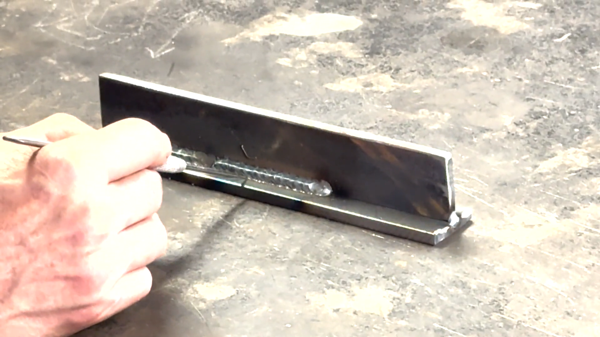

Practice on scrap first. Cut some small squares and weld them back together before you ever touch the tank. That's just as important as the welding itself.
Fillet weld on a scrap steel test piece
Then check yourself. Weld up a scrap piece, break it or bend it, and look at the broken face. Fused all the way through the root means you've got penetration. A line that never fused means you don't.
