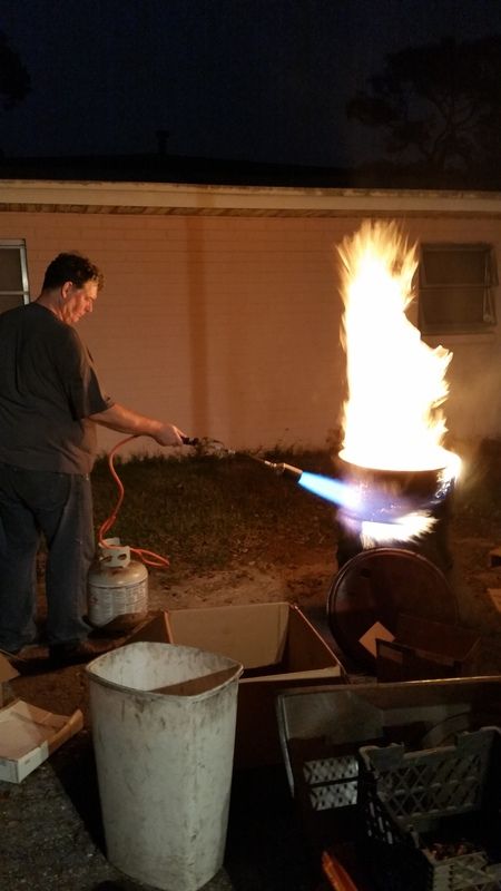

Somewhere was a post about Cardboard burning hot and was great for the burn-out. A raid of the recycling bin netted more than enough to fill the drum. I already had a 3,000 degree propane torch from a roofing project and this was a great excuse to play with it. Being dark I was able to see when the drum was just starting to glow red under 4" blue flame of my little toy. The black paint on the drum burnt-off to a white ash fairly easy but the red epoxy on the missed matched lid took quite a bit of heat. I got it too hot and the lip started to flatten out on one area. More hammer time tomorrow. Phase one completed. :-bd

As hot as you got it!! Don't try to wire brush or grind the coating. Use comet cleanser and a scrubber pad with water and the red coating will wipe off. Don't know why but it works. It must be burnt first, lol when I read my post it sounded like I was saying it wipes right off pre burn. Not.

I should've warned you about getting the lid too hot. I've got them so hot that they warped out of shape and I had to get another lid.
