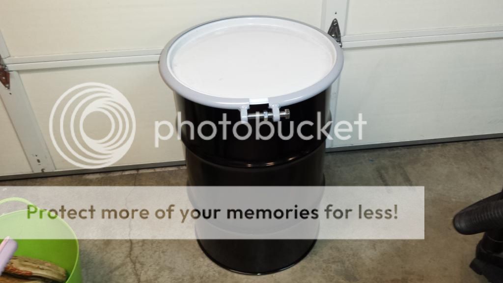

Drum came yesterday and it is built like a tank....might be heavier than my 55 gal. It's unlined so the build should be easy. My jumbo joe lid is too small so if I want to use it I need to add a metal ring inside the drum. Has anyone made a removable ring so you could use the flat lid or kettle lid? And I am going with adjustable shelving racks for more versatility.

I haven't made one, but I would use the lid that came with the drum and cut the center out of it and add the domed lid to that ring and that should do. Leave it on the drum while doing the fab work so it stays straight.

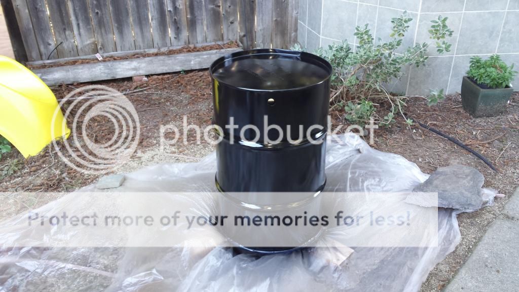

Got all my holes drilled and burned the inside and outside with a torch. The rust inhibitor came right off but the factory paint looks like new. I think the factory paint is rated for 450 degrees so I'm considering just painting over it. I sratched it up working on it so it needs a coat or 2. And I have some clear coat that is high heat paint.

I ended up taking the old paint off with wire brush wheel on a grinder. Wasn't too bad. Did 2 coats of high heat semi gloss and 2 coats high heat clear.

Post by The Czar » February 23rd, 2015, 6:39 pm
Oohh...shiny
