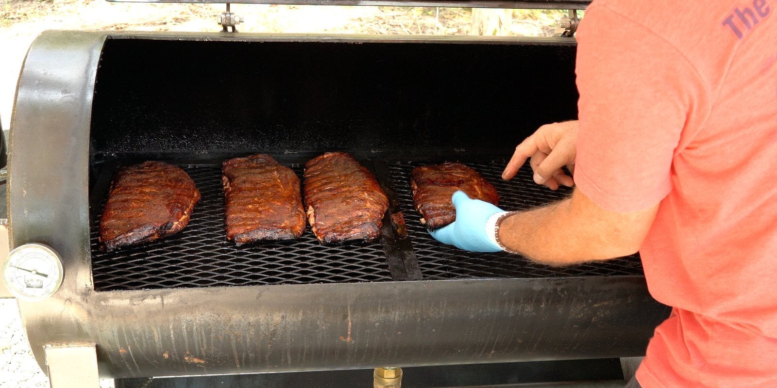

Measure the cooking grate in inches, multiply length by width, and divide by 144. That's square feet.
Figure about one square foot per pork butt, plus a few inches around each one so the air can move.
Four racks of ribs spread across the cooking grate of an offset smoker
Gallons still matter. They're what you size the firebox and the stack to. They just don't tell you how many people you can feed.

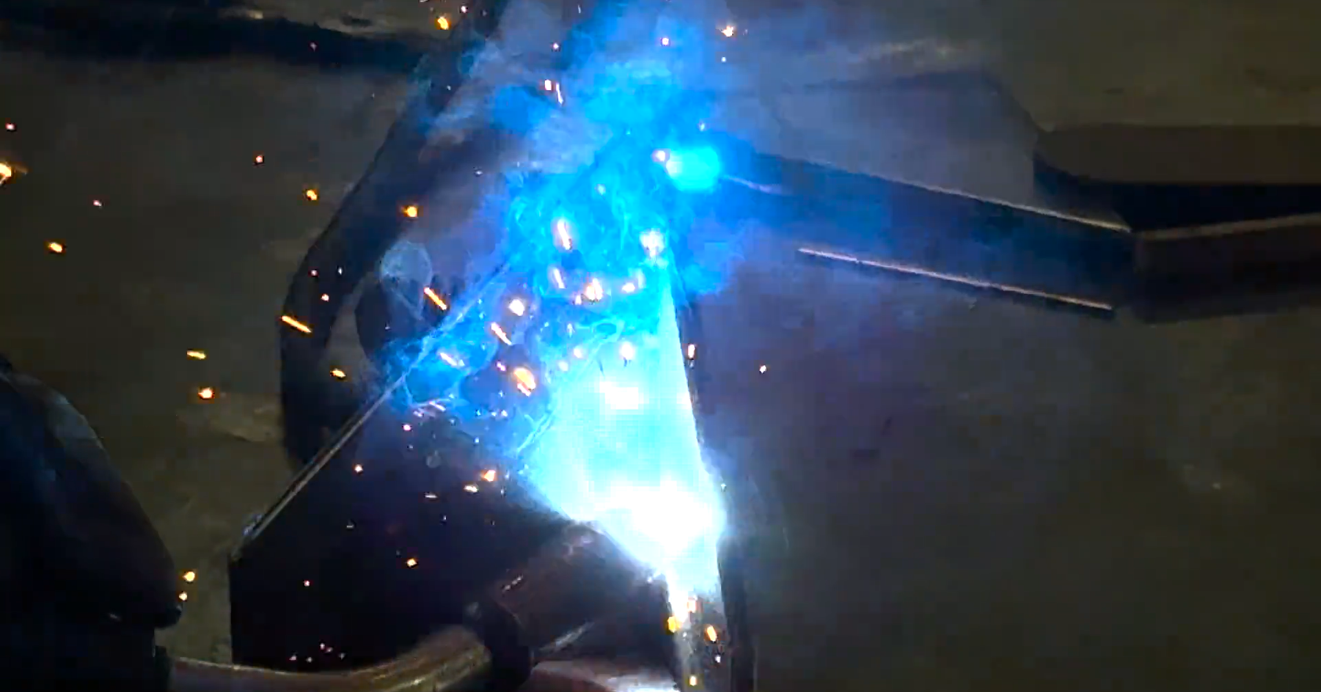

The welder. Buy an entry-level 200+ amp multi-process machine and start with MIG.
MIG costs about the same to get into as stick, and the learning curve is a lot shorter.
A multi-process machine gives you MIG and stick in one box for one price. And if getting a bottle of shielding gas is ever a problem, it'll run flux-core.
I've run the ArcCaptain 250 (about $500) on a smoker build and it performs great. Other brands are priced about the same.
MIG welding a seam on steel plate with sparks flying
Why 200+ amps? Roughly one amp per thousandth of an inch of steel. Welding 1/4" in one pass wants about 250 amps. There's just no reason to buy a smaller machine anymore.

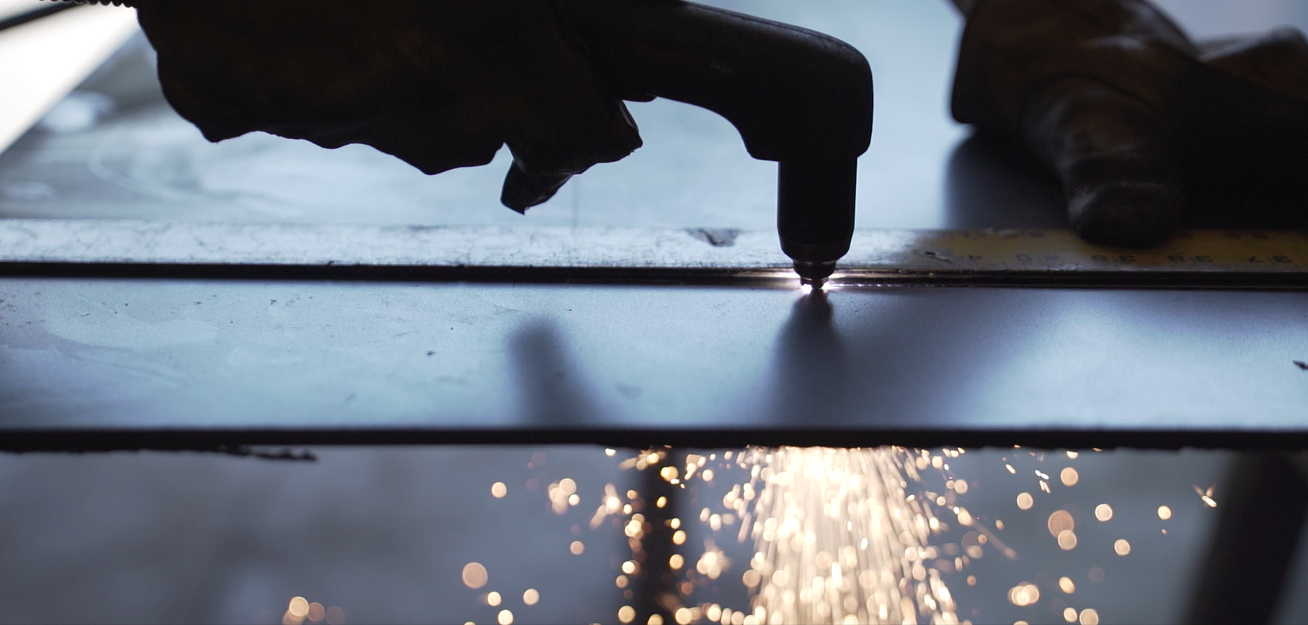

The cutter. Plasma. An affordable plasma cutter like the BestArc 60A (about $250, I've tested it) costs a fraction of an oxy/acetylene setup and it's a lot safer for a beginner. A torch is still handy later for heating and bending. Plasma is what you cut with.
Plasma cutting a straight line on steel plate

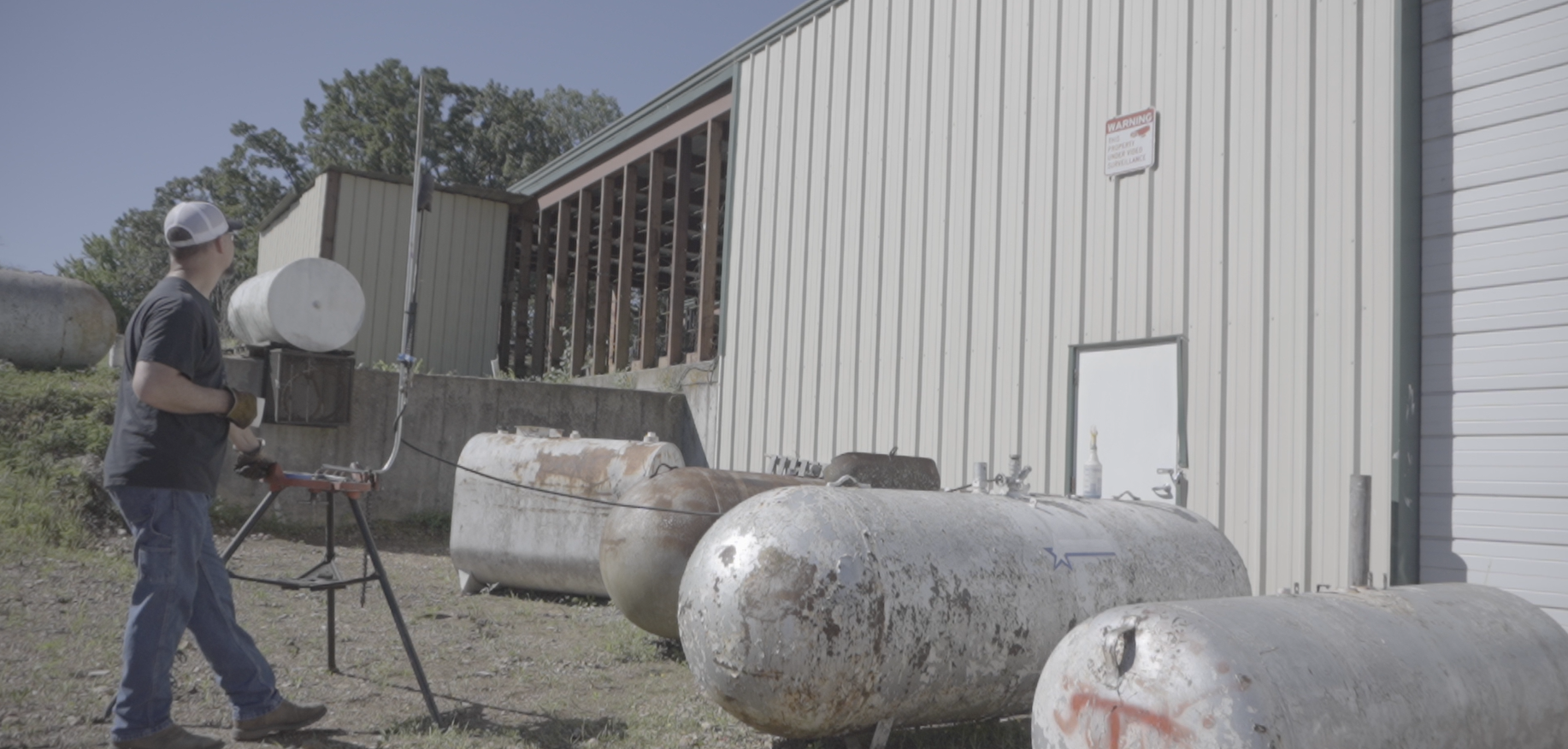

Used propane tanks lined up outside a shop
Where you buy it decides how much risk you bring home with it.
A tank refurbisher or a propane company is probably your safest bet. The tank shows up already purged, with the valves out.
Hauling a tank with the valve still in it under pressure is illegal here in the US. That's hazmat.
Never buy a tank somebody welded on in the field unless it's been X-rayed and re-certified.
More on where to look: Where can I buy a used propane tank for building a homemade smoker?
If you end up purging one yourself, know this first. The gauge on a propane tank shows how full it is of liquid. It doesn't show pressure. A gauge reading near zero does not mean the tank is empty of pressure.
And if purging a tank scares you, don't do it. Buy one that's already done.

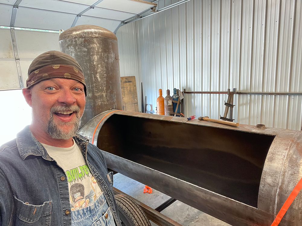

Frank Cox next to a tank smoker with the cook chamber doors cut out
Your tank isn't perfectly round. Propane tanks get forced into round when the heads are swaged on and the seams are welded. So no two are exactly alike, and none of them are perfectly round to begin with. When a piece won't sit right, it's very often the tank, not you.
Gaps happen. A small, even gap up to about 3/16" is good practice, not a flaw, as long as the weld penetrates. Every time I say a fit came out perfect, somebody in the comments calls me on it.
Tack, check, then weld. Tack it in at least three places so it can't hinge on you. Check it. Re-check it. Weld it out only when it's right… a tack is a lot easier to cut loose than a finished bead.
Cut in the right order. On a tank, cut and mount the firebox hole and the stack hole before you cut the doors. Cut the doors first and the shell can relax and twist on you.
