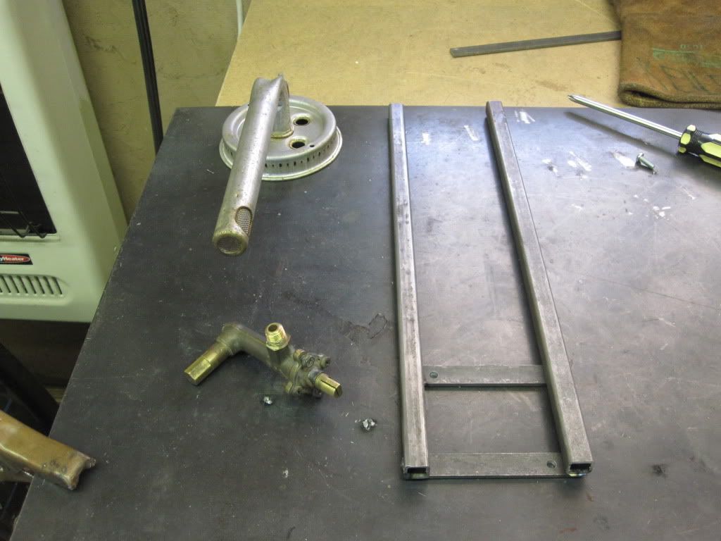

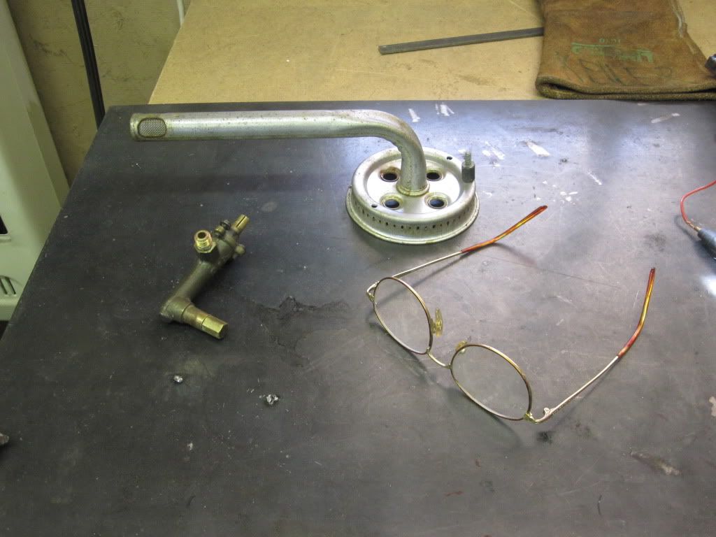

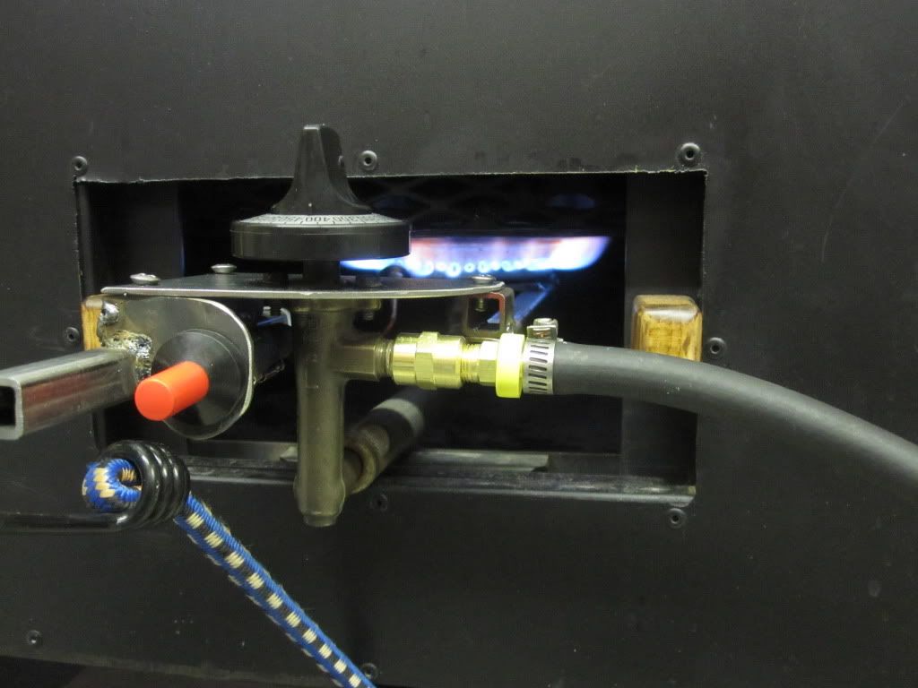

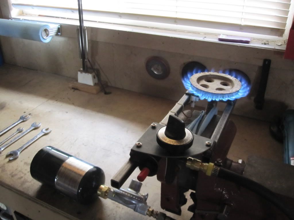

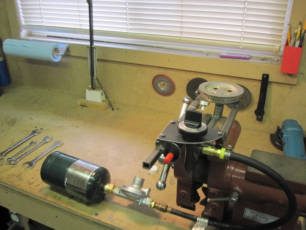

A buddy of mine was hauling a propane cheapo grill to the dump that had rusted out when I noticed it had a side burner that hardly looked used. So I pulled off the valve and burner and threw it in the drawer about 3 years ago. Finally got a chance to put it together to light Edgar a little easier.
Burner and valve...

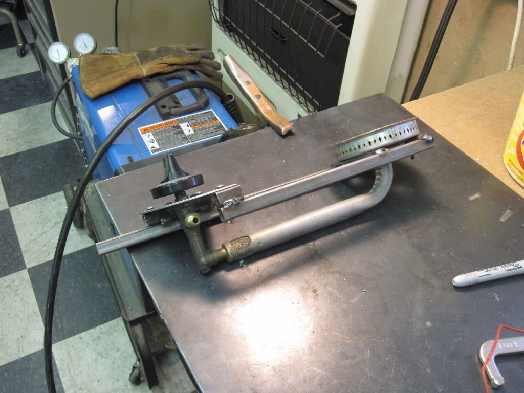

With framework...

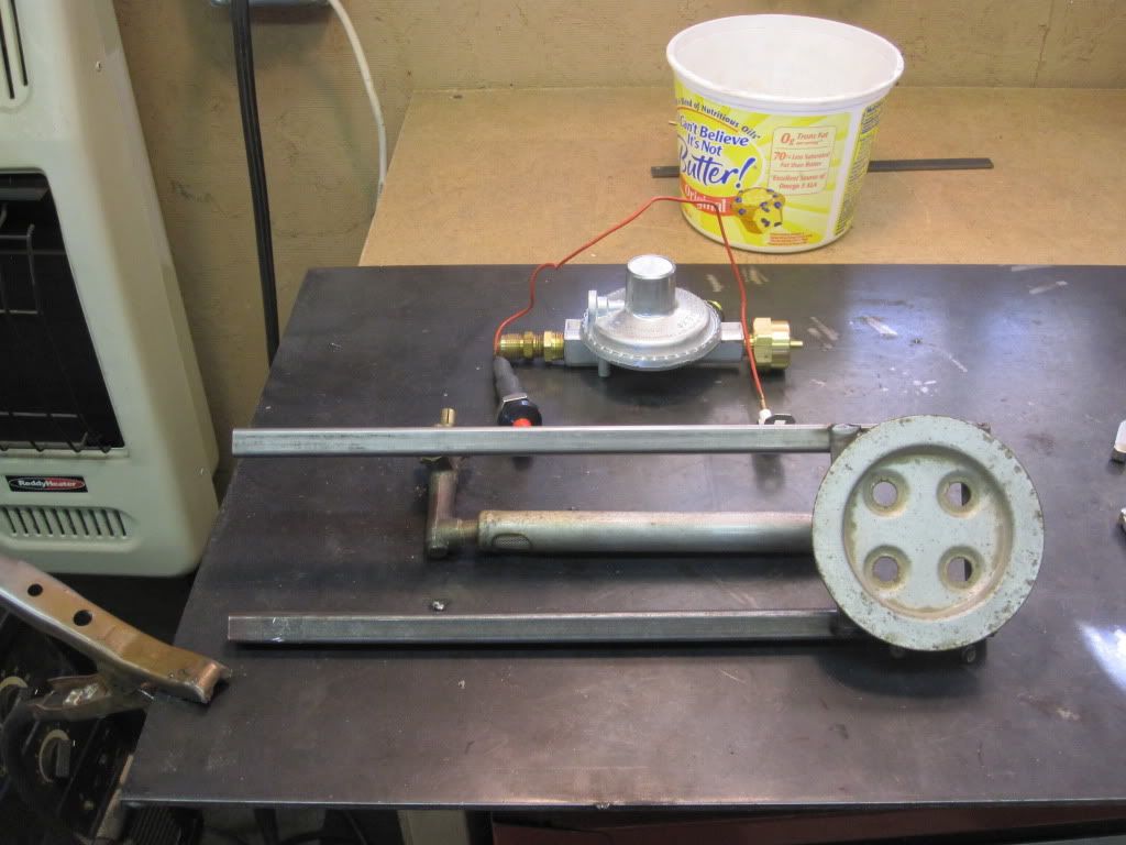

... and regulator and the dreaded "red button"
...and knob
...from the other side
...all hooked up

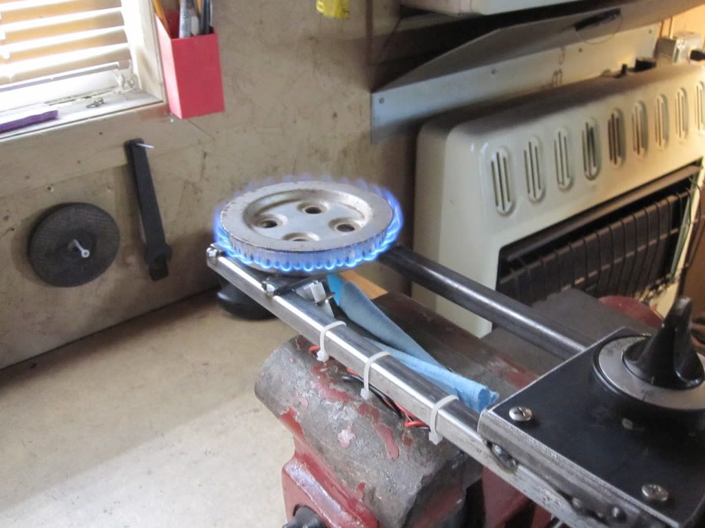

...it's alive!
...low setting

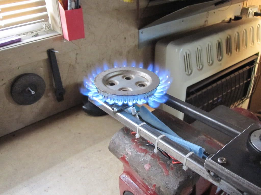

...high setting
That ought to light a charcoal chimney I set on the main grate to get things started.
ONE WORD OF CAUTION! - If you do something like this then do not operate it unless you stay with and watch it for the entire time it's lit - which will probably only be a few minutes. Propane can buildup inside an enclosed area and we'll be reading about you instead of reading your thread! I am as serious as a tax increase about this. I hope to add a flame safety to this in the near future that will shut off the gas if the flame happened to go out. I just haven't seen Frank's thread on how to do that yet... :)
